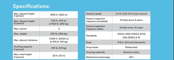

Thanks for posting that reference. One thing that caught my eye about these "emergency descent devices" was their maximum descent numbers. In some previous literature they have mentioned maximum descent height of around 1500ft (maximum length of rope supplied with the device) but they also have a "maximum descent distance" figure, that's tens of thousands of feet, in the case of the R550, it's 17,814ft.
I assume this to mean over the life of the device. i.e. once you make 178 descents of 100', it is suggested to retire the device. I haven't found literature that confirms this, but I'm sure it's out there if we look hard enough. Anyway, that number is not necessarily concerning.. but...
The "max hoist height" is listed at 33ft. I assume this number is per session, but if it is not per session and is instead over the life of the device, we would quickly be running into hot water.
Even on a single ascent, most of us are exceeding 33ft.
Maybe I will call 3M to see if they can shed some light on that 33ft number.
These specs are obviously very conservative ratings, judging by the various standards they have to meet in that list. The actual service life of any device like this would vary so much in real life that the ratings are basically useless on a practical basis. But in industry, they have to rate something so that it is absolutely trustworthy and they rotate stuff out to keep like-new equipment. For us, keeping the device clean, not abusing it in use, and renewing the grease inside on the gears at regular intervals would make all the difference. The thing is, it is no big deal if the device failed completely, the way we are using it. You would have your regular hitch or multi-scender above it for the actual life support, and could simply detach the RollGliss and descend at that point or switch over to foot or knee ascenders, etc. You would not want to use the device by itself for life support without your normal ascent system in tandem with it. I have many hours on mine at this point and take the cover off every so often to look at the gearing. It is holding up fine. I use a thin grease on the gears, about the consistency of warm Vasoline. The one weakness of the RollGliss design, in my opinion, is they use some sort of Teflon bearing on the shafts whereas a more expensive version would have ball or roller bearings. But I have been keeping an eye on these bearings in mine and they actually seem to be doing OK. The bearing material seems pretty tough.
Based on the build quality of the device, I would tend to agree. However, if they are taking into account the safe & useful life of the rope then those numbers seem more down to earth; especially after seeing what the sheave does to the rope after a couple of ascents. I have an email sent to their support team for clarification on several things including these numbers.
That's a good point. I had forgotten that they always come with a captive rope that can't easily be removed from the original unmodified device. The condition of the rope after a given number of uses might be the weak link.
