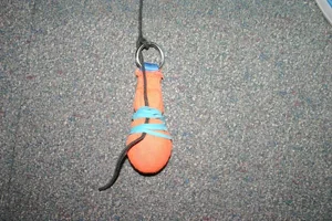

I like that idea, what if you used one ring and ran the tail through a fat rubber band on the Throwball? I’m going to have to try that tomorrow. It still won’t save us from stuck due to a wrap though, your going to have to work on that one.
Re: 2nd ring on the Releasable Throw Weight
A TIGHT fat rubber band might be just the ticket...that is well worth trying. Maybe it will eliminate that 2nd ring.
I'll work with that idea, too.
Dan, I tried the rubber band thing with only one ring...I keep the big long rubber bands that come on underwater disposable cameras so I used one.
I think you are onto something...worked very well for me. It was important to spread out the "legs" of the wraps of the rubber band to get enough friction to hold the tail of the throw line. At first, I had the bands all on top of each other but that didn't hold well enough. When I spread them out (as in picture) the friction was increased and it did fine. I made several 40-50 foot shots with my homemade hillbilly big shot and the bag stayed attached fine. When it did get stuck once, I pulled and pulled and it finally overcame the rubber band and munter hitch friction and let go...bag fell at my feet.
You can probably get too many wraps and get the friction too high...experiment and see. And I was able to use a fused end of the throw line with this setup.
Thanks to JimK for getting all this started.
