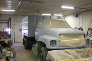

We sandblasted it down to get any pit rust areas out of it. It wasn't as rusty as you might think. We then built it up with lots and lots of primer and rust inhibitor then 3 coats of urethane plus a topcoat sealer. Spent a grand in primer and paint alone.
I did a 1-ton pickup this way 8 years ago - paint still looks great today.
