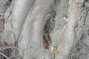

Red Maple decay
Didnt remove but a couple tangential ones, quite small.

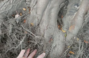

Back filled with a no- limestone -containing pea gravel with bottom of wound exposed. Mature compost and some of blasted top soil and old OM were raked back around the base of the tree.

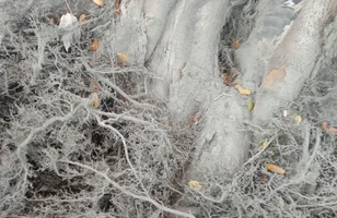

More close ups for you. Small and fibrous roots were emerging from endges of damaged areas.

Wanted to see how far down the decay went below ground level. It wasnt much further down and no sgrs were found. Backfilled with gravel to let it breath, added about 400 sq ft of new mulch bed to improve soil conditions around the tree. Plus, Guy asked quite politely to see more of the decayed area below grade.

Thanks for showing the beautiful root growth that nourishes the woundwood.
Backfill sounds good. When you see the tree next, that wound will be closing, and you will feel good!
Looks like Guy made the right call....again!
The bottom photo catches the imperfect (asexual) stage of that xylariaceous thing. Looks like brittle cinder except the later is usually more spreading. Whichever one it is, it is there!
Yes, woundwood reaction looks great though seeing those dudes on the old wood is disconcerting. Tree looks good but will have to be monitored
2.5 seasons was plenty to occlude--nice! Good vigor!!
