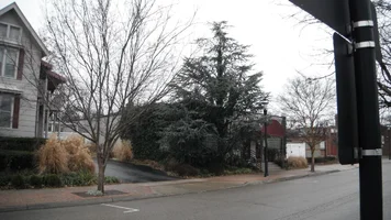

Just got rained out minutes ago so took a quick pict. on client's property, branch of Montessory School. You can try light cut backs. They even work on spruce at times when real light. This one's too close too. Rainy day doesn't enhance but is beautiful in sun.
Don't think I would disfigure the natural shape of this tree like suggested above whether or not a branch will survive. The growth characteristic is some of what is attractive about Blue atlas cedar.
I didn't suggest disfiguring the tree. The op asked if the tree takes to cutting back. I say you can cut it back and it will thrive. Not like a spruce. Of coarse lower shaded branches won't thrive as well but I would do a thinning of the entire tree if it was applicable.
