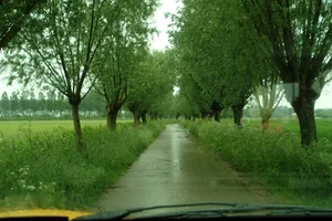

R Schra & Nathan,
Thanks for the pictures, do you have any more?
Nathan, What spieces are those? What is the aproximate height?
The trees Nathan posted look like London Plane to me. They are very good as pollard to and in France/belgium you see um a lot pollarded. Ill try to make some pics of willows, poplars, ash trees pollarded we have in our region.

Please !!! More pictures. I have been taking an interest in proper pollarding. Haven't been able to find much creditable info on line.

I second that those trees must start young. Here pollards started before 15-20 years after planting a tree will work, most pollards are simply made by 10 feet long branches cut in autum, put with the feet in a creeck or pond during winter and planted in spring. Pruning seems best every 6-8 years. Within that time some thinning the pollard every second year. That 6-8 years should also be the point were its most efficient to do in labor and for the environment (in fuel/energy consumption for the labor).
