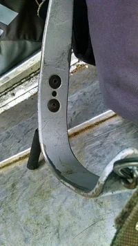

Look like they belong there, right? Can't wait to kick the tires on these. Why has it taken so long for someone to do this?

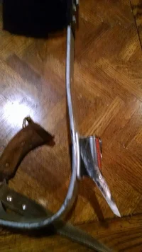

Did a few removals with the powerspurcender.Love It! Thanks Mike! Really nice even for just tending while stepping up on the tree if your not walking up the rope. Didn't even notice it . just there when I wanted it. Before I had this setup if I was spiking up I'd clip the tail of my line on a acc biner on leg strap of treemotion so as to not stab my line by keeping it out from between my legs . This setup works well for that but the line doesn't fall through the climbing device as well then because the wieght is redirected ,but the spurcender solved all that b.s. making for safer , faster ascents. And if you don't want to.stick to the tree its perfect! No more footie under shank getting all jacked up inside my foot. The 6061 conformed well to my bucklites. Yet seems very much rigid enough to endure some good abuse.Really can't thank Mike enough! P.s. his shipping speed rivals TreeStuff.

We had some storms here, Mac, and I had to make a quick trip to a nearby town to get a limb off a roof. It was still attached to the tree (green wood, tore badly) so I got a chance to try the Powerscender setup out. I use the SAKA, not the HAAS, but same setup, really. That clip on the left spur was the bomb, man. No more leaving the footstrap on the boot/spur and worrying about the wear and tear on it, and the crowded arrangement. Easy on and off, and no more spiking my own leg wrestling with unclipping it from the footstrap webbing while hanging off the rope. Stupid simple, crazy effective. Love it.
