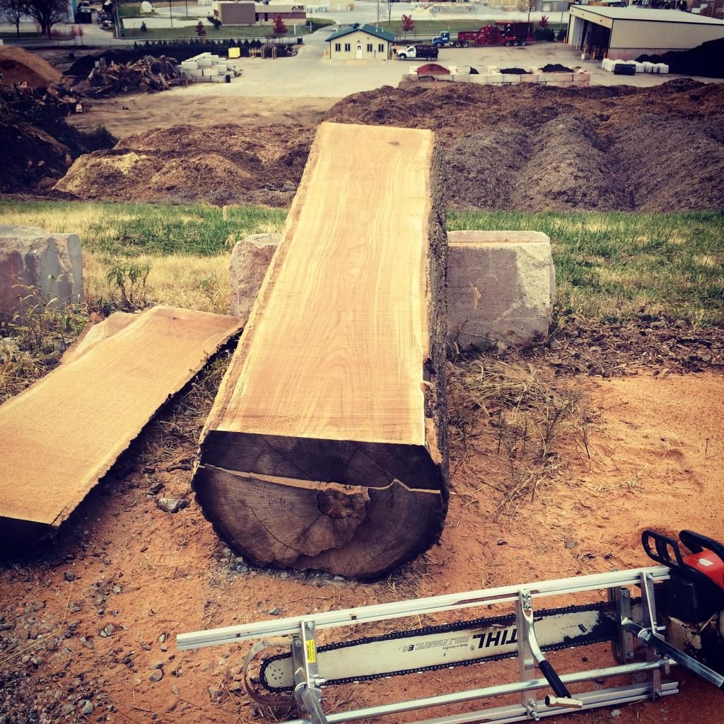

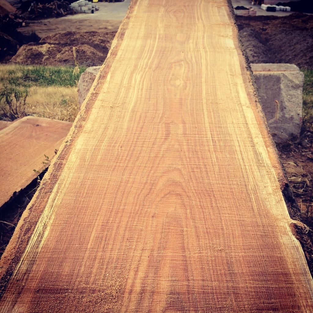

This is quite an old thread but I just started to chainsaw mill some slabs so I thought I would revive it. My father is now retired and wanted to do some more woodworking. We built a solar kiln to dry the wood. For me its nice to see some choice logs not turned into mulch. I posted a picture to my personal facebook and got a huge response. Dozens of people replied wanting to buy some of the wood. So I think we will start selling some small slabs on the side. Not a main money source but to me its fun to see the wood put to use and puts a few bucks in my pocket.
Pin oak slab.

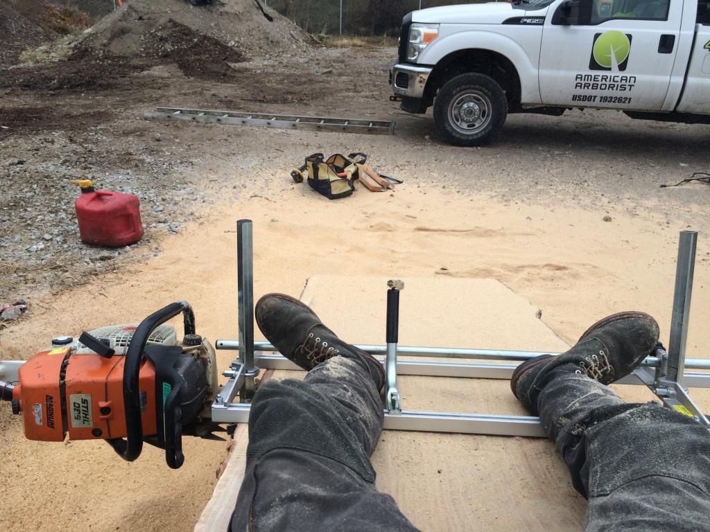

I've got the throttle locked and can simply sit on the angled log and guide the bar straight thru the cut with my feet. Works really well and saves a lot of energy.

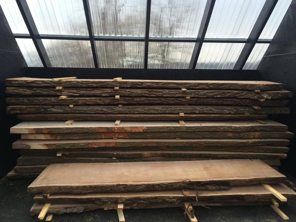

need a little work on the stickering, but have the boards stacked in the solar kiln ready to dry.
