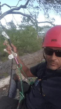

I’ve used a tubular belay device for long descents, the ATC Sport, but have switched to a carabiner brake bar for faster and easier installation.
Tsk tsk. Side loading 7075 (or whatever high-grade aluminum they are) carabiners with a piece of small diameter wood. You should be ashamed for promoting such antiquated and unsafe work practices.
On a serious note, how'd you make that? I saw the metal sleeve. Unless it is really thin, it looked like it would take some machine work to make it sit so snugly against the wood.
Edit: it looks like a tube. I hadn't seen it for a while. Still pretty cool, but less mystical.
