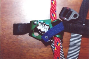

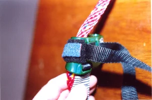

If anyone is interested finally here's my solution to the inadvertent opening of the Pantin.
As posted earlier, I used heavy industrial Velcro to keep the cam closed and that makes it infinitely adjustable, won't stretch when wet and is very easy to remove when in the tree.
Happy climbin/pantin,
CharlieB.
