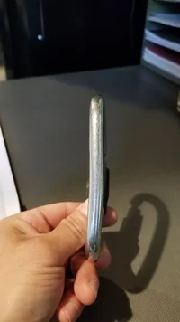

After reading the original linked Petzl document, one major issue strikes me. They do not refer to any specific type of carabiner for use in the choke configuration whereas they mention the zigzag and chicane directly. I'm no lawyer but I would think this opens up Petzl up to some liability in the fact that they are implying any carabiner can be used in this application. They didn't mention a specific carabiner because one does not exist for this application...yet. Though there are now quickie links on the market which solves the problem so just use that.
Do I think a carabiner will fail if used when choked to the spar...not the first couple times. Would I climb on a choked carabiner in an emergency, absolutely. Will I climb on a choked carabiner in every day climbing under controlled circumstances...nope. There are better designed and approved options.
Pic is an aluminum Petzl William ball lock that was used on a chipper winch...just for reference as what forces might do to the spine. This one has the old plastic gate, which also has cracks in it. I use this crab as my key chain carabiner now.

A chipper winch is going to beat on the rope and biner or whatever is used no matter how it's configured... Especially if not using steel. A climber is going to be hard pressed to put the same forces on the biner.
I have snapped plenty of 50kn binders on big chipper winch...
