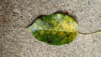

I wouldn't be surprised if it was anthracnose. We have a ton of it going on down here and with the long winter and cool spring and summer you have had, that would be my best guess. Hopefully KT will weigh in for you. I' m sure he will have better insight than I. Good luck in the diagnosis.

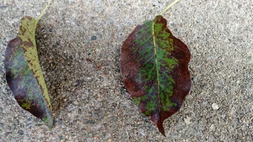

With photos, try to show leaves with both green and necrotic parts. Anthracnose is a good bet. I suppose we can rule out fireblight? That is very distinctive.

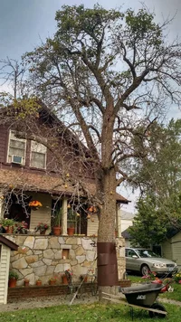

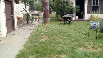

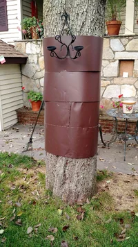

Here she is: Let me know your thoughts

So, this thing was completely covered in leaves about three weeks ago. Weird. Also, that side walk you see. It's been there for 100 years. Side walk came first, then the tree. This site has not been disturbed in any way. I feel it could be slightly compacted, but composted soil wouldn't do this so quick. More of a slow death.
Defoliation ain't death. I'm guessing twigs are still green.
TL is right; find the flare!
I'm not sure that is the issue. I mean, I understand that it can be A issue. But the grade has not changed in years. I'm not talking like 10 years ago, like 50 years ago. So, my first priority would be root collar excavation to find the flare? Then what?
I want to develop a plan for this tree to save it. This guy is really attached to this tree. He wants it to survive. I want to come to him with a plan in place to help save this tree. I first need to figure out why the leaves have dropped. I will say, it is dry around here, not much rain, and a lot off hot days. Drought issue?
Guy, you say a defoliation isn't death. I agree, the first thing I did was break the ends of the twigs and see of they were still green, they are. But, how long could you go with no food. This tree needs leaves!!

Your right though, there is no flare.

If the leaves evaporate (transpire) more water than the roots can take up, there comes a tipping point where the tree will drop its leaves. I believe this to be the case anyway. If the roots are struggling due to being buried, their uptake will be inhibited and drought will take a greater toll. A lot of things can bury a root crown without the owner even knowing it. Ant beds, volcano mulch, bad grade (if tree is in a 'bowl' of sorts). No doubt in my mind that is where I would start as far as a plan to save that tree. FWIW...

From what it looks like, as far as the surrounding grade goes, you'll have to be careful not create a well around the trunk when excavating it. Make sure when all is said and done that water flows out and away from the trunk, because it'll just bring sediment back in there if it flows towards the tree. My gut says that tree can snap back, though there is a nasty cavity on one of the leads. A lot of factors come into play when guessing if a tree can survive a leaf drop like that. I'd like to say most can, but species, and remedying the stressors will play a big part, in my experience.
