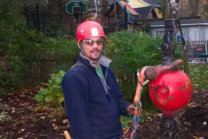

Todk (and anybody else) could you post a pic or two on how you tie in above the ball, with a brief description. It would definately help everyone I work with, including myself.
Here ya go Roger. A 17 ton screw pin shackle is placed on top of the ball. A 2' friction saver is placed over the pin. A locking carabiner is placed in the pin eye and the friction saver is placed through the biner. This keeps the pin from unscrewing. The friction saver keeps the rope from rubbing on the ball.
THAT SHACKLE SHOULD BE INVERTED!!!
Inverted...you mean end for end? PUt the false crotch on the curved end?
Not necessarily, I think. The biner locks the pin from turning and is clipped around the FC. How can the pin unscrew?
By setting it up that way the shackle has a chance of rotating. I'd rather have that than have the shackle jammed around the ball.
