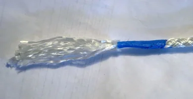

Anyone have any pics of the "ideal" amount of core to grab to pull through the cover with a tight small cover? I have the Toss video and that amount works fine on the other rope I've spliced, but for some reason I am making pretty hard work out of this 8mm OP splice.....
On my picture above I redid the splice three times...... Needless to say just do a full taper before the tuck. It works well that way. I bet I was down to 4 or 5 full strands taped into the end of my wire fid. I use electrical tape for mine and lube with liquid soap or spray Fantastic or something to make the tape slippery. The whole core is tapered down before the tuck. I found this will pull in quite easily........
I cut my two splices off the pinto and started again....
Tried just less than half the stands folded over to grab (forming about one thickness total). tapered the next two inches and wrapped very tight with blue masking tape.
Basically just a much more sano job than what I was trying.
The bugger pulled right through! Did in a minute was I absolutely strugglng with earlier.
Thanks for the tips in this thread. I've not had this problem before (bigger rope), but now all my db splices are going to be easier yet.
Pics after the pull through, but shows how slim the taper is.
