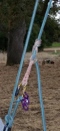

hello treeworld
i come to you in need of advice, i just purchased an online attachment prusik, about 8mm thick looks like ice line, anyways, its not what i was looking for, you see, im trying to have my hitch tendin pully up higher so that when im ascending into the tree i dont constantly hit the knot, right now im using a vt knot with a pully on a biner connected directly to my bridge. any suggestions fellas even with my extremely complicated description of what i use now, shoot, even if you cant understand what i said, let me know what yall are usin and ill just steal it from you, thanks guys
Can you get us a photo of what you're doing? I have a feeling what you've described is what most of the people here are doing...but I am not perfectly clear based on what I've read.
Do you have a small sling you could use to try something out? Maybe a 12" or 24" webbing sling, or another loop prusik, or something like that?

hey guys thanks for the input, ill do what i can nick as far as getting a photo of what im using now, the new piece of gear i just got today is on sherrills website and its called online attachment prusik, and as far as buying more gear, well, im all in cause damn if i dont have a problem with buyin tree gear, i think i need clinical help. you will all hear from me tomorrow the 12 hour day is gettin the best of me right now.
Hi Tom,
the advantage is for going up only, really - it allows you to hip-thrust with a distel/michoacan/schwabisch style hitch by putting the hitch further up the rope. usually once i get to the destination i re-tie the regular way to work. i used it today actually - i had to take off a bunch of stubs on a scots pine - since i was basically just going up right next to the tree and cutting them off as i went up it was a nice way to go. since i didn't need to do any other pruning on the tree i didn't reset the system - i just came down.
hope this helps -
peace,
mk
