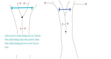

Someone please inform me here, is it or is it not recommended/ a BMP that co-dominants with bark inclusions should be braced, as well as cabled, in addition to possible pruning, whereas an excluded bark crotch doesn't have the brace rod as a BMP?
Does the brace rod limit the outward leverage created below the top of the inclusion on a compromised crotch when the tops move toward one another, with the top of the inclusion acting as a fulcrum point? (in addition to limiting the outward leverage caused by the tops moving away from one another (cable prevents this to some degree) that wants to pull apart the crotch from the top down)

Yes it is recommended. Especially when a split is involved. The brace is supposed to stabilize the crotch to minimize movement. I believe the BMP's say to put one bolt above the crotch (being protected) and then below the crotch no less then the diameter of the stem. Then on really large stuff you can go three I think. Sorry I want very clear in my post.
Thanks for this, I had never heard that rule before. Good to know. Ironically I've been doing it right out of sheer dumb luck!
