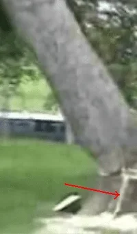

At 2:25 point it looked like the stump started splitting as the trunk went over...am I seeing that right?
Good video...that saw really chews through some wood.
More apt to be tearing because the stump wasn't nipped below the hinge which is more important when you are up in the top of the tree.
Good picture extract on that stump tear...gotcha, on the tear...kerf cut would have prevented that but it's no biggie on the ground stump.

If I were in the tree or selling the wood I would have nipped the hunge corners. Yeh that loader is much nicer than mine but he comes inhandy when I have alot to pick up.
The wood can pull because the notch closes prior to the hinge breaking and/or the hinge is a little too thick, no biggie unless it happens to be a veneer tree.
This one may have been from making the back cut a little too slow.
Boring the hinge will also prevent too much internal fiber pull.
