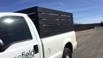

On work pickups, I built up the walls of the bed with 2x12 lumber ( or whatever dimension you want). It can turn out quite nice looking if you prime and paint the wood to match or contrast the truck, and makes a little billboard size space if you decide to make signs for your biz later on. Use the little stake holes in the bed sides and it can easily be undone.
A lot of tree guys around here do this.
Pics are from google but you get the idea. It makes so much more room if you are cutting down brush with a chainsaw back there.

Man, that is trim. And functional. Love the woodgrain look!
2x is way thick and heavy, but looks good.
Stakes and ply ( bolts, nuts, and washers) is enough. Light weight, maybe 1/3 the weight of 2x.
For a small rise, 3/8" plywood would be as light as possible. Easy in, easy out. Reach over the bed, not the walls. 1/2" would be better for holding in wood.
Not the room for error, when slashing down brush. When slashing down brush, you don't have much room for error, anyway...and you have a metal bed.
Depends on your needs.
Google thinks 2x6's are about 2 pounds per foot, probably with heavier hardware. Depends on if you will want to remove the side during the workdays or not.
Trailer-wall corner connectors will be an option for easy in-easy out.
