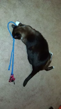

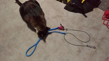

The cat seems to approve. Your system is much more streamlined than mine with knots. Are you going to use a pulley at waist or chest height?
I don't know yet. I plan on doing some testing this weekend. I will post updates as I go. I am going to test a bungee, a pulley and both. I might just get a retractable reel if I can't make something work well.
