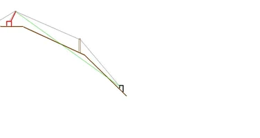

ok my paint skills lack but this is it. the red is the yarder (used to be sparpole) black is the tail hold, grey is how the skyline should run and green is how it would run with out the lift tree

Good illustration.
SPAR/SPAR TREE: A device rigged for highlead, skyline or slackline yarding.(2)
This doesn't really say where the location of the spar pole is, the assumption is, it would always be at the top.
"a device rigged" could be anywhere on site but because there is a Lift Tree it would make sense that the Spar is only at the top.
LIFT TREE: An intermediate support for skylines.(2)
