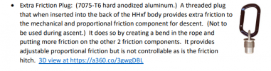

I should probably point out that this is not a rigging device. It is intended for climbers and associated loads. So if the friction plug is applied to the maximum extent it will prevent the rope from passing thru under those intended loads and those loads will not be great enough to damage the rope. As was shown in the bench testing, if the friction plug is inserted fully, it will hold the rope until the rope starts to fail and at much greater loads than would be subjected by a climber.
Secondly, even if the friction plug adds additional friction on a long or fast descent, care should still be taken with the amount of heat generated. Whether a device is fully mechanical or hybrid such as the HHxf, ENERGY must be dissipated and in this case, it will be in the form of heat. Textile to textile, textile to metal, or fibers moving within the rope caused by a bending movement within the rope, all generate heat in some form that must be dispersed.
Below clips from the HHxf Manual.
Im curious about Your addition of the friction plug. I climbed on the HH1 and HH2 for a while and did not personally notice a need for additional friction with those devices.
Is there something about the materials or design that necessitate The plug? Or is it more of a nice add on? If it's an add on, how much additional cost is related to the plug, and would you consider offering a streamlined version in the future?

I know you aren’t directing this to me but let me share that I climbed some 200’ Redwoods last week. The descent was long. Having the plug in place would have taken the heat buildup off the hitch.
My 2 cents. Good hitch cord, that is rated for high temperatures, is perfectly capable of taking the heat. It was designed to do just that. Any melted fibers that you find on a hitch almost always come from the climbing rope itself.

The eXtra friction plug shifts more friction to the body of the HHxf for long descents, more secure positioning or extra loads. Descents require the dissipation of energy and in the cases of our climbing devices it is transformed into heat and wear. I think we would all agree that metal does not wear as fast as a textile so there is that. Arimid fibers can take a lot of heat but even if they do they will be next to a polyester or nylon fiber so likely will glaze that as it goes past. Heat transfer is very fast and the chance of just flying over the nylon with a heat resistant aramid fiber without damage to the climbing line is not a risk to take.
The HHxf comes with 4 types of cord so a user can find what suits them best. Poly on Poly will feel different than Arimid on Poly etc. It is totally up to the user, type of climbing line and cord interacts with the weight of the climber and many other variable to provide ultimate choice. What one climber likes may not be perfect for another. The hitch I tie will slip or start to creep at about 20% above my weight. There are some reasons I find that a good thing, besides making the hitch smooth. One is that it would lessen any shock load if, heaven forbid, I end up with one or even an excessive load. Watched an example this week of someone getting crushed with their lanyard.
Another, if I need to take another climber down with me that same hitch that worked perfect for me now will creep. I could add a munter or some other friction but then my hand is dedicated to that. Adding the friction solves that.
So, if I'm making a long or final descent to the ground, I add the friction, not much heat on my hand, less wear, smooth easy to release hitch and I get a lot more life out of my hitch, not that 4.5' of hitch cord breaks the bank.
Oh, one more, when I'm sleeping in my hammock, I add the eXtra friction, the extra security makes me sleep better.
Hope that helps.
