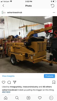

We just purchased a 2017 BC1800 demo/rental unit which I like because we basically get an extended warranty out of the dead. With about 150 hrs on it you figure all the little stuff would be worked out already. So far we really like it. We have babied it so far but have put 18" in it and it has no issue. Recovery time is so much faster. The remote that comes stock on BC1800 are a game changer. That's what the guys love the most. You never have to get off the machine.
