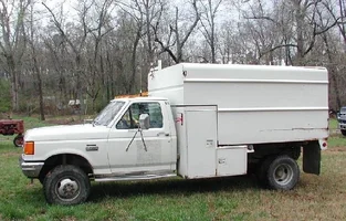

I bought a 1987 one ton 4x4, 4speed, 6.9L International diesel(non turbo) engine off of Ebay 2 years ago for $3,500. It has tool boxes and ten yard SouthCo chip box. 95k miles. The dump hydraulics are powered by an electric pump, which I like in this size truck. It needed one new injector and is going to need some clutch work soon. I can get this one ton 4x4 and my 250XP a lot of really tight places.....and even get back out!
I don't expect you will be able to match that deal but you just might(if you spend as much time on the internet as I do,LOL). I've seen a few newer ones for sale running about $7.5k.
Not running down dealers but my experience is that most of the 'steal' has been taken out of the deal when a dealer get a truck. I look for private owners. No doubt about it buying a used truck is a game of risk. (and new ones too!)
Here is a pic. Something like this would kick butt with that little chipper of yours.

I think you will find that a lot of dump truck bodies are way heavier than boxes built for chips. That extra weight can be a drawback especially on lighter trucks like a one ton.
My thoughts too Tree Co.

I just went back to craigslist and the listing has expired. That would have been my only pic. I haven't taken any pics yet but will post one when I do. I've got the same 5.9L in my Dodge PU and the engines sound the same and it's kind of weird...because of course the gearing is so different. My retired 1983 F600 has a 8.3L Detroit Deisel not turbo and it's like driving a lead sled compared to this smaller 5.9L turbo charged Cummins. My 83 has a very heavy chip box and that doesn't help.
