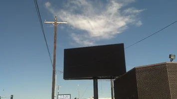

I backed out of a LED bill board setting job yesterday, after visiting the site twice in my car and eyeballing things. I then went down to the local utility and gave them a headsup. They indicated they were familiar with the project (the 16" 20' high pipe was planted last week) and that they would PROBABLY have a line crew there to wrap the lines. The next morning I show up and no line crew, I was told that we were 1' away from the 8' limit from the main feeder lines, so 9', so I was on my own. Then for the first time I talk with one of the sign guys involved with installing the steel pipe the week before, he commented that the ground was saturated even 8' down, and that there must be a spring or something in the area.
This got my attention big time. Then I look at my right outrigger: on lots of padding but on asphalt a couple inches from the building. We know that the soil there was disturbed when digging the footings (10 years ago anyway) and whether the soil has sunk leaving the OK looking asphalt with a void underneath is unknowable util the 14 K load is swung over that side, no way to "sneak up on it", and yet another set of power lines (smaller, just feeding a small commercial building) waiting just down stream in case that outrigger settles. The left outrigger is on a small stretch of lawn, that was soft to walk on. The busiest street in town is 8' to my side, with no traffic cones or traffic diversion in effect.
I tell the sign guys (I work with them often, a good crew and on my side) that I have a bad feeling..... but I go ahead and set up anyway. I lift the sign off the trailer, and find it only weighs a bit over 12K. They pull the trailer out and now it's decision time: I need to winch up 20' to lift it over the building right next to me on the right (which had people in it) and then swing 160 degrees and THEN find out how solid my footing was, now with power lines on BOTH sides, (both in the fall zone, in effect) and with traffic whizzing by on my left at 40 MPH. I paused for a couple minutes and then told them to grab some stickers, I was setting it down on the sidewalk while they called in a bigger crane. I had run through the #'s if that suspect ground was as wimpy as I feared: a re placement crane, paying for a new $80,000.00 LED billboard, repair or replacement of the commercial building alongside of me, a lawsuit over loss of biz while they rebuilt, another lawsuit for loss of revenue from taking the powerlines out, which feed Pocatello's "miracle mile/main drag", and several more lawsuits from crushed or electrocuted, or both, passing motorists. Not to mention getting fried myself.
All this for a job that I could bill for maybe $350.00, as it would only take 1.5 hr at most from setup to driving off. I had three more jobs lined up that day, several others in days to come, none to my knowledge remotely involving putting my nuts on the chopping block like this one. I have yet to talk to the head honcho at the sign company, and I see the next day the sign was set in place. I sent him a bill for 50 bucks "off loading trailer", and have since decided I will call him and tell him to tear the bill up, no charge! My bill had a brief list of my concerns and why I pulled off, and while I expect no hassle from him for the wasted time, you never know..... but if he gives me the slightest hint of displeasure with my decision, I will for sure tell him to attempt impossible acts of self flagellation. I do know that I have been high fiveing myself since backing out of that job, I still have a crane, no new lawsuits, no newspaper headlines, and my life. A no brainer in retrospect of course. The picture shows the installed sign, note the power pole right behind on the right side, and the big boys (main feeder lines I was told) on the left, screw that.IMG_20150903_125410_875.webp
All this for a job that I could bill for maybe $350.00, as it would only take 1.5 hr at most from setup to driving off. I had three more jobs lined up that day, several others in days to come, none to my knowledge remotely involving putting my nuts on the chopping block like this one. I have yet to talk to the head honcho at the sign company, and I see the next day the sign was set in place. I sent him a bill for 50 bucks "off loading trailer", and have since decided I will call him and tell him to tear the bill up, no charge! My bill had a brief list of my concerns and why I pulled off, and while I expect no hassle from him for the wasted time, you never know..... but if he gives me the slightest hint of displeasure with my decision, I will for sure tell him to attempt impossible acts of self flagellation. I do know that I have been high fiveing myself since backing out of that job, I still have a crane, no new lawsuits, no newspaper headlines, and my life. A no brainer in retrospect of course. The picture shows the installed sign, note the power pole right behind on the right side, and the big boys (main feeder lines I was told) on the left, screw that.View attachment 33278
That soggy ground was the deal breaker, just too weird. I could just see, or at least imagine, a big leached out void beneath the asphalt, and right where I'd be loading that outrigger the most was right where I'd have no good options thanks to the power lines. Just too tight all around.
