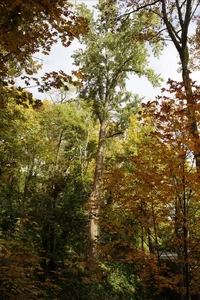

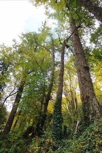

Attached photo is the base of the tree. The maple next to it can be removed to make room to work. The road is just above, a hairpin laden road that encircles the perimeter of Mercer Island. Nothing can land on the 40 degree slope.

The canopy. Those limbs are rather large and brittle, with a less than adequately strong high tie point. But, I was quite sure that we could safely lower the linbs, in two or more pieces in many cases, to save crane time and road blockage. If we'd have landed the job, I'd have gotten a Wraptor for canopy access. Going to buy one anyhow soon!
By the way, by far the highest bid on this tree was by Asplundh at $35,000 and change...They obviously didn't want the job, or have no clue how to do big trees....

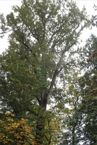

Here's the privately owned tree, just 80 feet away. While it might be tough to lower the brush on the other tree, it's not possible with this one. Thus, a total crane removal. 100 ton crane barely adequate if parked near the tree..which means total road closure for two days......
or minimum 175 ton crane if working at a 90 foot radius, where it might be possible to keep a lane open......
job would have to be done during spring break when there's no school buses running. And that is when the other co is doing the job.
I'm really rather livid...as I know this company has no clue how to do really difficult trees, when there's limited crane access.
Both these trees are about 40-46" where they branch out, at about 80-90 feet....they ain't little!! And cottonwood can weigh as much as 80-100 lb/cubic foot, down low where its full of water, even this time of year.....So, that weight must be accounted for when craning, especially at an extended radius.

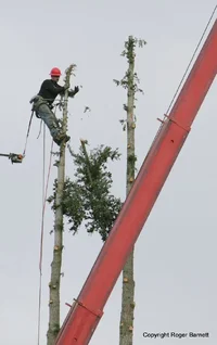

Enclosed photo and following post's pics are examples of their work habits.

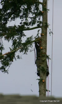

Note he's left his lifeline in, but untied from it.....(old school, friction knot tied in tail....)
One hand on saw...but I have no problem with that....

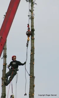

No eye/ear pro......nice nick in his only tree attachment (well besides his gaffs...)
Nice saddle too....not....no straps to keep his butt strap from riding up...
He was smooth enough, and had no qualms about going up into a small top...

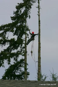

I hate the one pic per post on this forum...that's why I usually embed images from my online site..but didn't want to post these shots there.

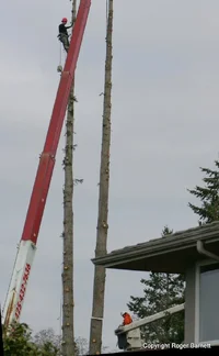

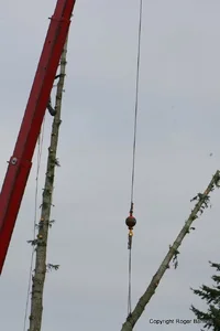

They were fast and efficient, with the bucket guy simply pulling away from the shorter fir that he was delimbing and topping out,to go over and make the cuts.
