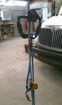

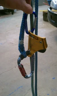

I'm looking for feedback on my frog walking setup. I've got three pictures. The main thing I'm questioning is the tether between the Croll and the CMI dual ascender. The mini biner on top of the Croll attaches the the "cross-chest" member of by Buckingham suspenders. The knot at the CMI is a butterfly. The other leg of that rope is a footloop and I have a Pantin on my right foot.

If you can find a way to attach the croll as low as possible on your harness. I'm talking below the waist low. You will have a easier time staying parallel to the access line. Make the length of the tether from croll to CMI so you can cycle from mid chest to comfortably just over head and you'll maximize efficiency.
What you have should work fine, but you may struggle to keep your spine in alignment. That costs efficiency/energy.
Tony
X2 what Tony said, but it looks good. I might try to introduce a chafe sleeve in the foot loop next time, but its easy enough to take out a brummel and put one on it. Looks good, Id use it.
