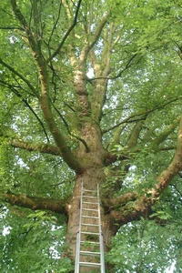

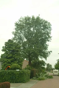

So yesterday i went to do this. A 80+ year, 65foot Acer saccharinum. It started to die back interiour branches so i lightend the crown.

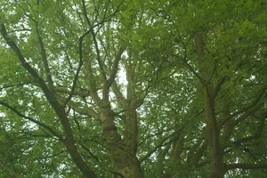

finished and now cleaning up + removal two cherry trees.
Took me more time as expected to do that Acer. We had rain for an hour and reasonable wind so getting up those limbs became a hard slippery job. So what would a time estimate be for this tree for you guys?

you say 2.4 hours or 2 till 4 hours ;) It took me 5 hours to climb (incl. coffee break) and an hour to remove the 2 cherry's and final clean-up. i was there alone and one groundie. at all we took away 1306 Kg chipped wood. I think that the rain and strong wind hold me back for 1-1½ hour.
OK so I was an hour off, 3.5 minus 2.4. Can't judge the extra time needed to lower vs. just drop limbs. I've never seen a silver maple in the US look that good.
2800 pounds of chips?

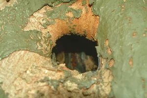

It was just drop those twigs (ø 0-5 cm). if they didnt get struck lower in the tree. on the house/horse chestnut side i shortened some limbs back. biggest cut was about ø 10cm on 25 year old wood. Also for here its a very nice tree with a good build crown. Only one minor or eventually a major problem. In the past three limbs were cut at the main trunk and there rotting in. very good reaction growth and enough good wood. but in future its gonna need to be checked reguarly. About that time it just depents on the climber i quess.... im not that fast as climbing ist just a part of the job.

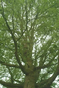

inside look before work

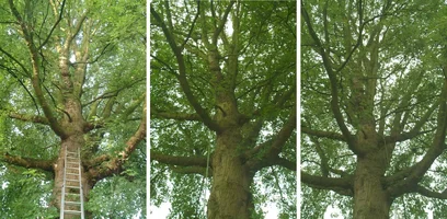

inside view after pruning
But never the less i composed one that shows
LEFT - before pruning
MIDDLE - left side pruned, right side to do
RIGHT - after pruning
516 kB and 2036 x 1000
rgrds Ronald
