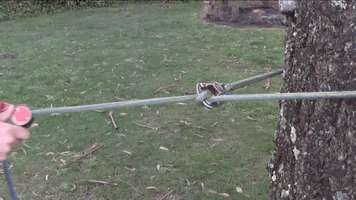

Moss Cinching Lanyard prototype
My buddy Josh was talking about a ring on his lanyard when these things came out. I kind of like the idea of being able to just slap it in until it holds.
The version of it without the webbing has a tiny hole that no normal biner fits, as I remember. I think only a shackle or quick link would fit. Its also double action and will let go after the second trigger unlike a biner. It has promise though, I like it. I just wonder if it would stand up to abuse, tolerate cinching well. The instructions do say to not hang it from a rope loop or side load it on an edge, the latter not being a surprise.
Also, this video made the rounds before but seems relevant. I wonder if a lighter weight biner, one with an H cross section vs round, would tolerate this as well.
I also thought about a soft 8, but thought that it would probably only twist when loaded. Maybe a flexible 8, with something like zip strips inside it, would be firm enough.
Stopper knot on the tab side...just as normal. Essentially the soft 8 seems ideal for cinch anchors because it is flexible to cinch down on the stem or branch and nothing gets side loaded
I tried using the cut figure 8 in a large eye with a carabiner also, but it didn’t work very well. So made something that can be added to a regular lanyard. It was after it was made that I realized the truncated eight piece wasn’t necessary. Time to get the hacksaw out.
For me the question is can it be choked tight on the spar or limb/branch and loaded down, sideways or whatever direction you wanted to load it. Looks like it could be.
-AJ
If you wanted to be extra hardcore you could clover hitch it or munter it ... but that actually seems to hold pretty well. I’d say it would work on anything over 3” by the looks of it. Especially if you’re using a thinner (<11mm) rope

Just wrapped once inside the snap in the picture, but the same would function with a carabiner. Alternatively one could tie a clove hitch for security or a munter for some adjustability.
