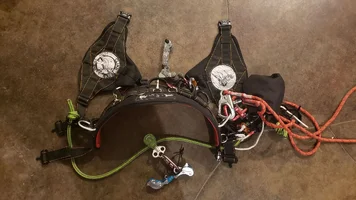

I let my extra straps flop around for months, then I realized it was a safety concern and I wasn't going to suddenly double in size. So I cut off the excess, melted the new ends, sewed a small fold into each end, and then lightly tacked the straps all down with thread that I could rip loose if I ever needed to adjust them again.
Now it is sleek and fits perfect every time, no more slippage to deal with.20200322_203451.webp20200322_203451.webp

This is what I do, as well. I try to leave enough for someone a little larger than myself, in case I sell the harness, or get fatter. I tack the ends back with a Speedy Stitcher with about four stitches, so they stay out of the way and the adjustments can't slip. Easy to cut a few stitches back off. I don't have the MB, but it works on any harness where the excess is a hassle.
