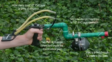

I copied from NewTribe Tec.
I will get some pics of mine and start a new thread.
