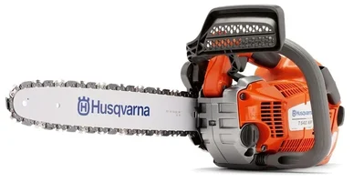

For whats its worth I'll be sticking to using my stock ms200t until it dies then trying out the Husky 540 when it makes an appearance.
