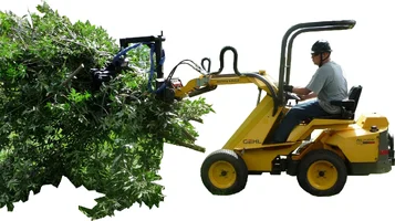

The Gehl is the best type machine for what we do, that said I paid 16.5 for new in 05
they are very dependable, but that price is steep,
1000 hours or less - clean - + a new BMG, I have sold a bunch used for 12 & 13K
they hold there value very well
The other 2 are tracks, no comparison

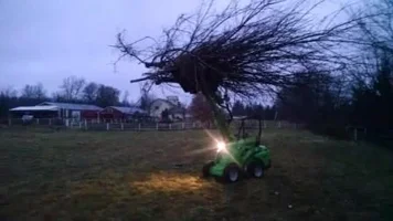

and buy a new Avant 420 or better - you will never regret it
2 year warranty - lifts higher - modernized - bad ass baby loader
Gee I just happen to have a demo I believe

I think I paid $12.5 for my al20 in 2003.
I've more than 2500 hrs. on it including the original ag lug tires. It's probably the best purchase I've ever made in my 25 plus year career.
Still runs like a top and the dealership I bought it from says I can still get parts for it. That price is high but in most cases, you get what you pay for.
Oh... replaced a couple fan belts and 1 wheel motor. Oil changes on the Kubota 20 every 100 hrs. and no, it doesn't use oil.
