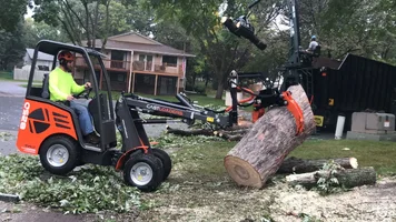

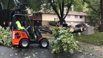

Ditch Witch all the way. We have had others and run almost all of them and they are superior in all ways. We have a 750 and an 850, just sold our 650 which was awesome as well! We have both a branch manager and a vermeer grapple. Both have great features but the bm is preference. The crews literally take a mini everywhere unless its a drop and leave scenario, no questions asked.
How many plywood pieces do you have to bring to each site? Do you have to put them anywhere the mini goes, or just where you will be turning? Trying to decide between a mini and an articulating machine for tree work. Thanks!
I own both, if the wood pile is right by chipper the mini skid will indeed win, grab spin and stuff. Fun times! If tree is in back yard and chipper on the street, on the giant I’ll be finishing up lunch before your done loading plywood back on trailer. Both are great machines and will not disappoint!

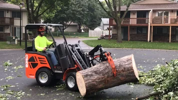

I agree with you as well after buying my Avant 528, it’s lifting capacity and stable ness is amazing, and yes the only neg is not good in mud and 36” gate issue, I kept my mini skid also, but overall if I were to only buy one again it would be the Avant. Getting on and off is a non issue. Having a roof over your head and the controls top it off!
I am looking into the 254T, one issue I am thinking about is it is too tall to get into my shed or garage. What are your thoughts on keeping it outside, with a tarp or build something to drive into, like just a roof. Also, is there any problems driving them up the ramps into a dump trailer? Thanks!
The Giant tele 254 is 10x better than a tracked mini, I have both. The mini is better climbing snow or mud on a hill and gets in a 36” gate. I have used my mini one time in the last two years, the Giant goes out ever day and will do circles around any mini out there. I do have the wide tires and all are filled solid which works great.

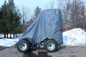

Is the cover easy to get on?
yes easy enough to get on, 4 snap straps, picture is the one with over 3000 highway miles on it
down side $999
