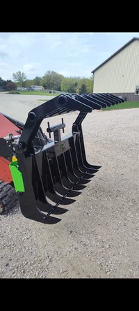

So we have been fine tuning this grapple in house, and we use this for 95% of our work. We do not chip - we use a grapple truck. We have worked out the weak points, and added stiffeners and the cylinder covers, and have enough hours of use to be confident in the design. We sell these on a limited basis, but they are a premium option with a premium price.
Love that you put the Bollard on it, we just added that feature to ours and our big mulch buckets
