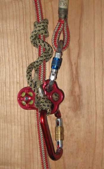

So I've just started using a micro mouse as a single attachment point to my harness, in the same configuration as alot of people seem to be setting up the hitchclimber. Problem is my climbing hitch is not biting reliably after it gets advanced...
Anyone else have this problem?
Is it any better using the hitchclimber?
Thanks,
Rob
A possibility is that the upper carabiner may be putting the splice where it pushes on the hitch, keeping it open under tension. If so, try some different sized carabiners. The Petzl OK is what works on the HC.

Aren't the holes inline on the micro mouse? I found when I used the top/bottom hole config on the HC, I had the problem of the hitch not biting because the legs of the hitch were forced to be splayed out onto the cheek plates of the pulley. When I use it (as I always now do) with the offset holes (hitch on bottom hole, eye splice in middle) I get perfect bite.. Using both 8mm b-line and ice tail, dressed onto tachyon. Man, I love the b-line~!

Tom,
You should try moving your eye splice into the middle hole. In the set up you are showing, the carabiner pushes the legs of the hitch onto the cheeks... causing them to splay out. When in the middle, the legs can run nicely along the faceplate of the pulley... nice and smoooooooth..

Yes, I am an idiot.. !
I saw the picture, then just blazed through the text.. man, to much coffee (or not enough?)
Ok, how about this picture?

I had similar experiences with the micro mouse. Try an ISC gator biner up top. It is small enough that the hitch can't get underneath top of the biner when taking up slack. Good luck.

micro mouse gave me the willies as a single tie in had no confidence becouse of the hitch getting cought in the biner i use the Petzl oks

I think the best small biner is the Gator. You can find it on most arborist supply stores.
