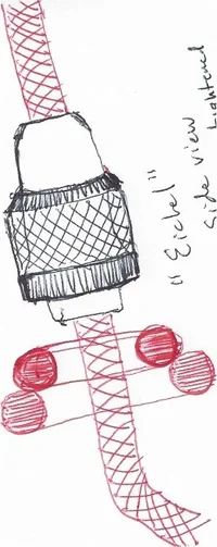

Thats right: a collet. But how will it be tightened? By means of a nut...that leads to how to thread all the rope through the nut to get to the piece (being installed midline). That would add a lot of hassle. Can a nut be installed mid-bolt? How to tighten the collet with a slim mechanism that is solid and load rated...? Somebody will suggest an answer...

The whole motivation of the idea is to try to create a slender profiled mechanical stopper knot that will bump through the canopy with less trouble than a stopper knot and that will make use of existing ring on ring technology.
Alright, last call for the night. I've included a new drawing of the thing here with a ring tightened down on the collet. Its drawn rough again, and not exactly to scale. BTW, the only way this would be viable is if it proves to be lighter and more efficient than a stopper knot. It may knot be. It may be a big, heavy piece of aluminum that gets jammed into tree crotches. I just thought I'd push this thought experiment a little bit. I can't take on shepherding this thing through to production, but would gratefully hand it over to a manufacturer who could. Any further thoughts or suggestions are much appreciated.

What about a system that works like a PulleySAVER, but it has a hitch to hold the climb line in place? To retrieve, it would be like unthreading a Rr, but there would be no retrieval ball, just an eye splice that makes the hitch back through the large ring. I'll take some photos today if I can work up the system. No stopper knot required, just an E2E, 2 'biners, a Pinto, and a hitch...the hitch would have to create less friction than the backbone of the FS on the branch. Might be more complicated than it's worth.
I can see that design working, you would have to thread the rope through but it makes sense in theory.
Can you explain the overall goal? I understand getting rid of the knot so the rope pulls smoothly but there is still a friction saver that is trailing behind to get stuck. Also it sounds like a lot of rope to pull just to move your tie in. Seems like you would be solving one part of the problem but not the whole thing.
