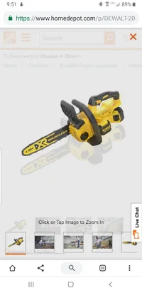

I have the 20v DeWalt. Love it. Auto-oiling, brushless (the brushes and communtator are often what goes out first on these type tools), and no tools needed for tensioning. Same battery fits all my other cordless tools including my DIY power ascender. I have three batteries and can go all afternoon without a charge and still have juice left. I don't notice much difference in cutting power over the small gas saws I have had in the past. My largest saw is still gas but I find that the DeWalt is becoming my No1 go-to for the majority of what I am doing. I must qualify my remarks by saying that only I rec climb so I am not using my saw at height very often. But I use it very heavily on the ground for cutting firewood and other stuff. I have even used the DeWalt for whacking up railroad ties for making raised flower beds. It is a tough little saw, just like everything else they make.
Watched the video and enjoyed seeing the take-apart. I have not had my DeWalt apart yet. I have indeed noticed the bar wobble a bit on mine but have gotten in the habit of letting the blade take its own path instead of steering it sideways too hard. My larger gas saw benefits from this kindness as well. Like any tool, how long they last depends a lot on the particular user. I have a ham-fisted doofus neighbor who could wreck an anvil. He brings his saws and other stuff over to my shop for me to repair them so I get a pretty thorough close-up look at what can happen to any power tool. The little DeWalt would not last 5 minutes with this guy. But neither has anything else he owns.
