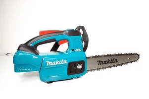

I notice the Makita 36 volt also has a stated 3940 ft per minute chain speed. This to me is a great departure from the low speed (typically under 1000 ft per minute) high torque setups common with many of the older electrics as a low speed high torque chains render protective gear much less effective.
I hope this trend continues with higher voltage and larger drive sprockets.

Yeah I took the number from a page on the Makita website ( https://www.makitatools.com/products/details/XCU07PT) .....However it seemed a little hard to believe (and looking at another Makita web listing it says 1650 fpm) that's why I typed a "stated" speed. Your number seems a lot easier to believe, thanks for the information.

Interesting that the 20 MPS does indeed convert to 3937 FPM or 4700 FPM for the 24 MPS. Pretty incredible chain speed, which is a great departure from the norms of the older crop of electrics.
Bore Cutting with either saw. The 36v can be pushed hard and the 18v cannot be pushed at all;
It has a captive bar nut, a three position adjustable oiler, the oil cap looks like it seals better than the 36v unit. This should have been my first purchase (instead I bought the 36v first). I just assumed that the 18v would be too puny and weak to do what I wanted in a tree, but it cuts great with a sharp chain.

Anyway, doubtful I'll do a video soon, but if you need a sweet in-tree saw, you can not go wrong with this thing. 6lbs and change, 4000+fps, Makita quality... DO it!

Chiming in: I picked up the little Makita XCUO6Z a couple weeks ago and it is a lovely little saw. Very light, nice balance. As others have noted, you use it in place of your Zubat quite a bit so it changes the work positioning for all those cuts. It has been handling 4-5 inches every now and then no problem. It is much better at cutting small stuff than my Stihl 200T, which has its advantages. I'm really liking my first battery powered saw, it's a different way of going about the chain. I'm still in the early stages, will finally get it into the tree later today.
