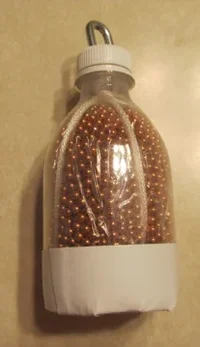

I picked up a Canada Dry ginger ale bottle while walking the other day. It was the perfect size for a new two-pound weight and much sturdier that the bottle I've been using. A well-proven concept in a nicer package.
The BBs are double-bagged in zip-lock plastic and make the weight a little softer since they move around so easily. It's also 10 grams heavier and almost two inches shorter with the same diameter. I closed the bottom with foam rubber held in place with gorilla tape. The nylon line carries the load to the chain link attach point.
