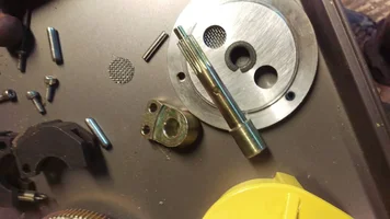

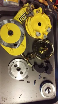

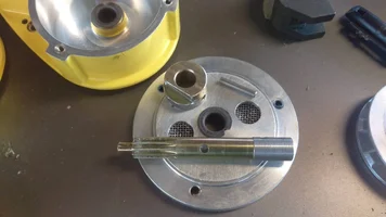

first I'm getting rid of the clutch and working on the input shaft
I used a lathe but the metal is so soft you could probably grind the 5/8" shaft down to 1/2" with a bench grinder
grinding the clutch mounting ears off was almost too easy - the metal grinds easily
It was easy to take apart - I ground the end of a framing nail flat to make a punch and all the pins came right out
I'd recommend taking it all apart just to get some grease on all the cheesy dry stamped steel bearings it has - removing the rope grab and clutch has made it smaller and lighter - the clutch is a good size chunk of steel that is not necessary for ascending if it is even reliable for descending trees
next I will have to test whether anything can or needs to be done about rope friction - on the bench it sure seems to have a lot of that
