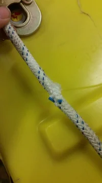

Just a word of caution to anyone using system, the rope grab says that it is rated for 5/8 rope. I read that upon getting it, and later forgot because it came with a system to use it on a 3/8 rope. Well I tied into the rope grab (with a pulley clipped to it) with a moving rope system, did a test ascent up to the rafters in a pole barn about 10' up. Then repelled down on the climbing system. The rope grab slipped and although it did grab, it cut the sheething of the kernmantle. I would highly recommend a smaller rope grab or a friction hitch above the rollgliss.
Was that damage just from lowering into it or dropping into it? I have used the rope brake and it is aggressive but it has not broken the cover on the rope. I will admit that I don't like that it is rated for 12mm and it is being used on a 9.5. I have a foot lock prusik above the rope brake, above the r500 for a backup. So far so good.
The grab is probably harder on our softer regular climbing lines. The stuff that comes with it is really tough stuff and quite hard-surfaced once you hang on it. Not really very good for normal climbing but would hold up to hard use like that steel grab.
That was from descending on my hitch from about 10' up. I was tied into the rope brake with a moving rope system (through a pulley attached to the rope brake) its possible that I came to a stop mid way down and that may have increased the force a little. But I did not drop into it. At the point that it slipped, I had already transferred over to my other system and removed the r500 from my harness.
Just to clarify, the danage was done to the static kernmantle that came with the r500. I am using that rope for ascent and switching over to a different climbing line once I am in the tree.
Interesting. Well, we have better equipment available to us now than these heavy duty steel grabs anyway. I tossed mine aside and will just use them for rigging work and other things besides climbing. While the design of the grabs is well thought out, the actual construction seems a bit crude, with sharp edges and such. They don't compare favourably with my various ascenders and other gear.
