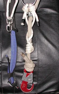

Steve I've posted these pics before but here is how I have a dog swivel incorporated into my tres cord.
oh and also, does anyone have any thoughts on mounting a position to the d's without a biner? only thing i can think is girth hitching a quickdraw sling to the d' and attaching the sling to the positioner in place of standard mount.....but that would probably be too sloppy
Steve, when I used a positioner I removed the stock alum. biner tether and replaced it with a twisted clevis.
It kept the P lined up straight and didnt interfere with the rope inside the P. Lemme see if I can dig up a pic
