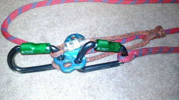

Although it has seen limited use, I recently switched to 12mm Sirius bull rope for my lanyard with an ART positiner 2. I'm really liking that combination. I also have a fairly generic double action snap (non swivel). I spliced the tail end with a carabiner for a DEDA option, and leave the carabiner attached to my harness when not in use, to prevent accidental self tailing of the positioned. 20180208_085616.webp
