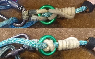

This is an ideal alternative to a mechanical rope grab, especially from a minimalist perspective. I'll use a 5 wrap, with a cross-over in place of what looks like your overhand knot behind the ring, as shown below on my 30' lanyard. Here's the front and back view to show more detail.

Not quite right, the braid in back needs to be a twist. The way you show might work, but I think after a few cycles of up and down it will start to tighten up. The hitch on the right shows the twist before the eyes are put through the ring. Another tip is it needs firm cord that stays round.

The overhand works best stretched out a bit, so an oval works best with that hitch. This one is much easier to tie and adjust.

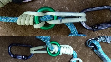

I hear you and I'll play around with it some more, but here's my take on it so far, using 8mm RIT and uncrossing one of the two crosses. I think you're right that it'll eventually bind on SRS, but for MRS it should be fine, as it's not much different with a micro pulley, except for the ring being integrated into the knot itself.
Here's your version with the added twist inside the ring.

Lanyard yes. MRS yes, but not as well without a hitch tending pulley. SRS is probably pushing the envelop a bit, but I bet it runs pretty well with a Rope Wrench. Depending on the climber-hitch cord-climbing rope variables, I may be overly optimistic, but for some it may even perform like a simplified Hitch Hiker, at a fraction of the cost.
