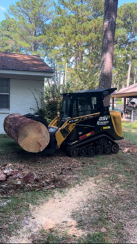

I'm probably an oddity, but a couple years ago I was wanting a small forwarder, ran the gamut of machines vs what I wanted functionality wise... ended up deciding on an ASV RT40 with cab/ac. 2 years later I'm still very happy with it and would replace it with the same if this one died.
Travel speed is great, ~7mph
Lifting capacity is decent, ~1klb at 35% tipping capacity, it can tote the mail down near the ground.
Lift height is decent, it can just get over the side of my 30 yard 16' dumpster with 7' sides on the ground.
Cab/ac is fantastic for comfort.
Suspension is generally great, although it can get herky jerky/bouncy on clean dry pavement
It goes to basically every tree job and handles most of the day to day forwarding.
Caveats:
If we're doing a bigger or specialized job we'll bring the larger track loader or excavator to help with efficiency or lifting heavy. The excavator can lift considerably more than the grapple truck.
I generally just have to get the material to the grapple truck (it normally just forwards material, it doesn't load it)
It's 4' wide which fits beside my stump grinder on the trailer in front of the lift... I don't work through 3' gates.
It could barely get this off the ground, storm work, minimal yard damage after we got back to the grass, especially compared to other options (or the ~$180k in damage to the home).
