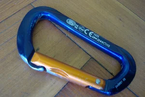

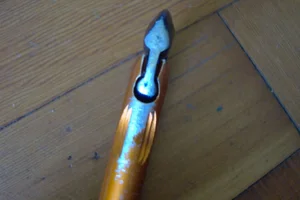

I think the 0426 refers to steel or alloy used, as I have a few with that same number.
The pictures below show one that I use at home on my 6:1 rig, gets a regular 200>400kgs pulls, 20 odd times a day, has not failed yet...
