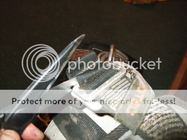

I use the Kolibri as well, most comfy harness ever invented. Roger you dont have to step into the legloops, they open up, you just need to cut the weird little fabric loop (not load bearing) and the fastener will come through the rectangle, I'll post pics soon to show you.

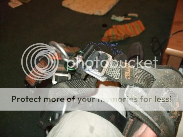

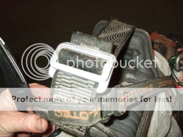

Here's the legloop thing - this worked for me, just cut off the thin webbed loops on the legloop buckles, then the smaller buckle just slips out at an angle through the rectangle.
hope this helps

After I modded the legloops buckles, they adjust fine and stay static throughout the climb, even long climbs.
What I would say is that if anyone doesnt feel comfortable making this modification then dont do it. I'm self-employed so its only my responsibility, but I suspect an employer would frown even on such a thing.
