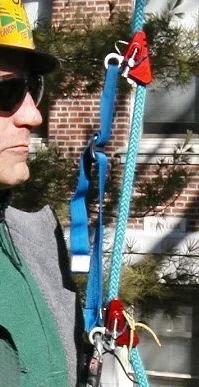

During the development of a dual attachment SRT system I started off using two Micro Grabs. You can see then in this pic. The lower would tail along passively. If I needed to move back down the rope I could reverse inch-worm by releasing the top one and letting the tether bunch up. Then I would loosen the lower one. At no time did I thumb the cam on both ascenders. That could have allowed a fall. Thumbing both cams was tempting but this would negate the dual attachment system.
Be sure to look at the next pic too for how the Rocker was incorporated.
When I found the Rocker I realized that it was a better unit to use for the lower attachment.
It would slide up the rope easier. Installation was a bit easier. The nicest part was that I could flip the tab and lock the rocking mechanism in place for positioning. Using the Micro Grab in the lower meant that it would slide up the rope sometimes when I was moving around.
The picture isn't real clear but I think that you can see how the Rocker worked in my system. The bracket that is taped/epoxied onto the biner kept the Rocker from sliding down the spine of the biner. Think of it working like a corner trap does on the curved part of a biner. There is a shoelace tether in there so that the whole system was chained together. This reduced the fumblies.
