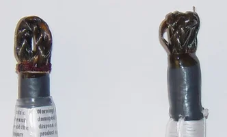

Need some advice. I bought a couple of Ultra Tech eye&eye cords a while back. I recently opened up one, and it looked like the attached image. It doesn't have any covering over the underlying fibers. Would they be safe to use, or should I return them?
Thanks,
Jim

That's the way they are supposed to look, though the eye on the right looks a little funky.
That'll be one of the splices we go over in the latter part of the class!
love
nick
Thanks, Nick. What made me wonder was that the cord I got from another arborist site has the covering over the eye. That doesn't compromise anything in strength?
Actually, the eye on the right I can't get a carabiner through, so that cord will have to go back. The second cord I can force a carabiner through.
I'm looking forward to your class. See you in a couple of weeks.
Jim
We'll go over all this in the class, but in that rope, practiacally all the strength is in the core alone. The cover is just to protect is from dirt, sun, and dumbness. It is okay to use it core-only. It's better to use it with the eye covered as well.

Nick,
Why is it that the splycers don't leave the mantle over the eye and make it a clean covered eye that the sun can't deteriorate.
This one (a footlock prussic) is (in my opinion) done in a much cleaner way. The mantle is tucked away under the (don't know the English word)takeling.
Wolter

Nick,
Wolter
Wolter- in some ropes, it is very difficult and maybe impossible to get the cover back INSIDE the rope. It is a rare occasion when I will leave the core exposed, but every now and then I have to. In a rope (such as ultratech) the cover doesn't NEED to be involved. There are easy ways to keep the eye covered, but NOT tuck the cover inside, too.
And in english, the takeling is the "core" (like spanish Corazon, for "heart").
It is possible to make one exactly like your picture where the cover DOES go around the eye part, then is stitched down (like the red/yellow whipping that you have in your picture). Maybe that is what was done in the picture you showed?
love
nick
love
nick
Nick, I am happy that you explained it and in your explanation you gave me the answer.
Takeling is not the core but the whipping (in this case red and yellow, and yes that's wat is done. The splicer tucked it nicely under the whipping.
This way the core is shielded from UV.
Wolter
