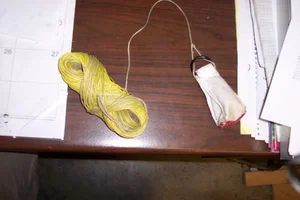

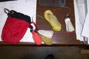

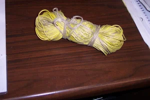

This is how I store it. It tangles very rarely (<1%) and then it most likely was my fault. I'll try to post some more pictures and if i get time this weekend a video. It may take a little longer than a flaking it into a cube (never used one) but I can have all 180 ft stored in less than a minute (just timed it). With this method you have to tie the weight to the end of the line you started coiling. Using the other end will tangle every time. This kind of hard to explain i hope the pictures help.
Setup for when i throw it. I attach my extra weights and storage bag to the other end to hold it on the ground. sometimes when i have used the bigshot it won't spill out quick enough and it take the coil into the tree. the extra weight prevent this from happening. I have turned coil over so the line coming off the top of the coil.

Althor. I trust you but don't believe you. That looks crazy to figure eight it like that. But! It does kinda make sense and I will give it a try.
